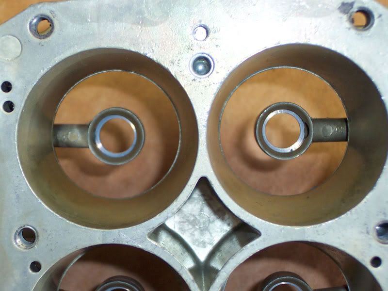

Okay, I broke down the HPI carb looking for secrets. There are none. The mainwells use a #2 tapered pin reamer just like the rest of us. The emulsion package is nothing remarkable. It's what we are all doing to 4150 carbs.
Only in the boosters do I see anything special. They are standard .178 passage 850 boosters. It looks as if the builder machined the steps into them himself. The step is .4698 in diameter and .320 deep. Booster ID is .375 with an outside diameter of .620 or so.
I sent photos to jmarkaudio. Maybe he can post them.
Bruce

Not anything I see out of the ordinary, other than Bruces 850 does not have a stepped booster, when we put our new emulsion back in the Demon it does. I think it will be the best so far of the 4150's.

Stepping the booster allows an area for the fuel to flow around without blocking the hole. They spray better with a better fan and finer drops because the fuel can exit the delivery tube and be contained in the stalled area under the step and then exit into the air stream. The resultant fan has more even AFR spread around the fan or cone of fuel.
 Post subject: Re: Another E-85 Convert
 Post Posted: Thu Oct 06, 2011 8:12 am
BLP sells a variety of stepped boosters, they come with the booster passage in different diameters for different carb sizes and fuels. They also have a Braswell booster, a stepped booster with the exit taper that has an outward radius. The Demon booster has a step and then an angled chamfer at the bottom. Both I think were done to spread the fan or cone of fuel wider off the bottom of the booster.
