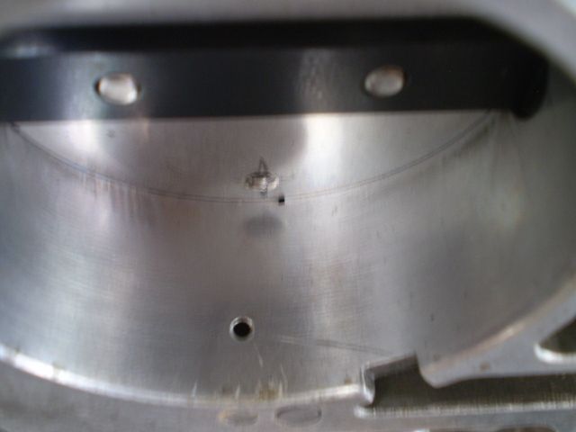

Here is a pic with the blades fully closed. I installed the ball valve and with it fully open that is somewhere about an 1/8 pipe fitting hole I can close the speed screws to a 1/2 turn. It will Idle but seems a little lean when dropped in gear...I am feeling like Ron here and almost ready to throw in the towel with this carb...This issue with the T-slot looks a lot like what Scott had with his and he started with .090 holes in all four blades.. I have .140 in them now and with out the ball valve the speed screws need to be at 2 full turns to get it to idle and like said it's now idling on the T-slot..So where from here.. :-
 Post subject: Re: HP Dominator Idle
 Post Posted: Sat Jul 07, 2012 9:26 am
Posts: 11644
Barry didn't you have this same problem when this carb was on gas? :-k
