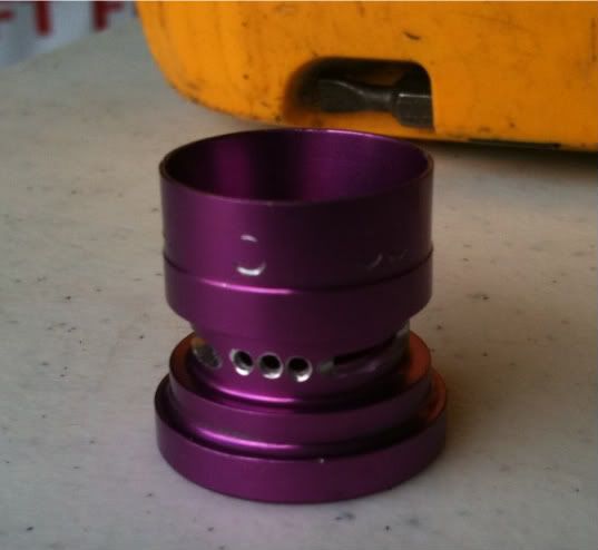

Software reflash, had to get Racepak on the phone. Not sure what fixed it, did several things. The carb is off, adding .059 holes between the slots. Two between two spots, three at the booster exit. I will probably plug the bottom of the two open ebleeds, leave only one in the second position. If that does not bring it down I can do some jet drilling, I have some alky Demon blocks I can get larger jets for to try as well if I don't get much response.

OK, after removing the inserts, adding holes, plugging the lower open bleed it seems to be the same. Also added a vacuum port to my spacer, so the vacuum sensor is working, .5" WOT. Going to make a trip to BLP tomorrow, get some larger jets. They have up to .177's for gas blocks, if it needs more I may need to make a metering block change. Here is the latest screen.

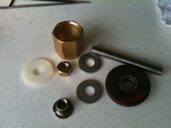

Booster mod
Tools to R&R
