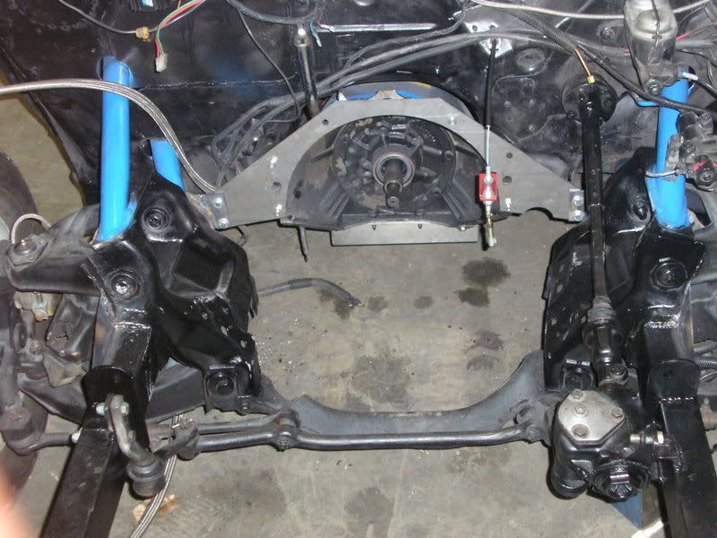

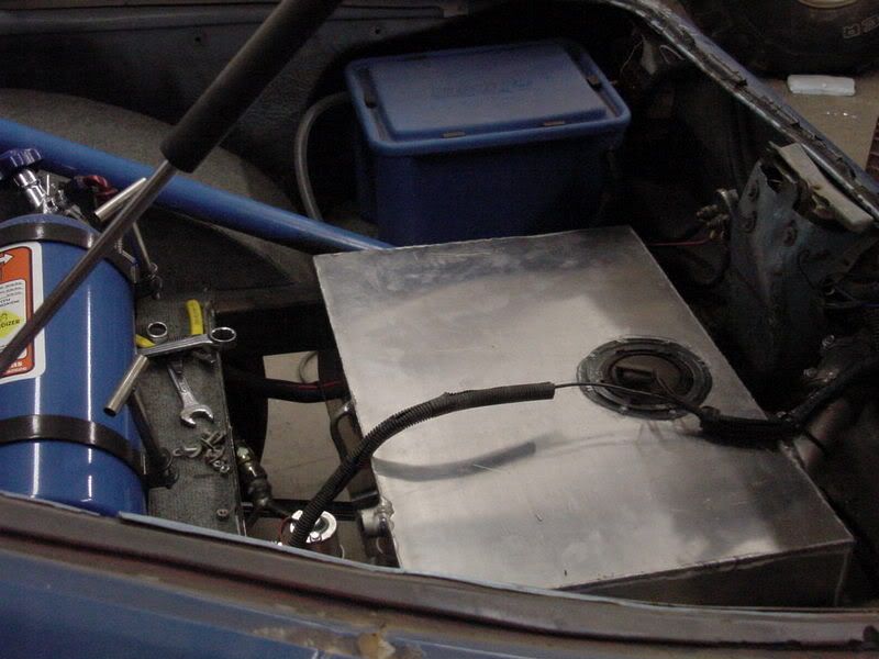

Yep Jeff,very interested in the gear set,let me know how much.As far as the verter,ran the number stamped on it 400010 and it looks to be a herbert cheapie 10 incher for a glide.Not much info on it other than that.Yes that motor mount setup will have to go(sooner or later).Thinking of just a motor plate in front much like the setup I did in my old malibu.Should work.We'll see.Also gonna put a mid plate in(maybe a pic?).
Got a pic of your fuel cell/batt setup in the rear?Something else I'll have to tend to. Looking the car over last night,list started growing,and kept growing.Maybe I bit off more than I could chew,I hope not.Got to keep telling myself "keep it simple,take it slow,dont rip the whole car apart!" lol.

Hey Tray,
The only pics I have of the midplate and fuel/batt. are old but I will post them for you,also when I changed the frontend and added the midplate I found lots of small cracks in the factory front frame rails so I spent some time cleaning all the old paint/crud off and welding the cracks back up and grinding smooth...just something to look for

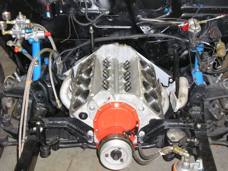

Hey Tray,
If you dont want to use a motor plate I could build you something like these...just a thought

inVEGArating wrote:
Hey Tray,
Those sure do look alot better than whats in there!Let ya know thanks!
