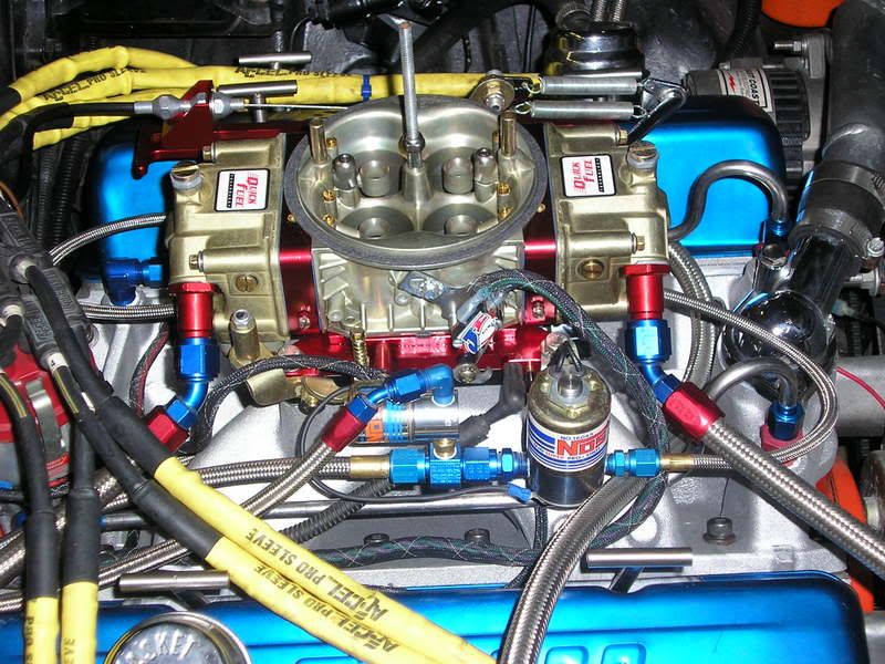

Sorry guys I'm not smart enough to figure out how to get multiple pictures in one reply.Most of the car is the same as last time we talked except the Donovan aluminum block is in it now

Very nice, what does it run,specs, details? Oh, one more thing, more pics we like pics. =;

Oh Man,, Aluminum block!!!! Now thats cool \:D/ \:D/ Good luck with it Jeff!!!!

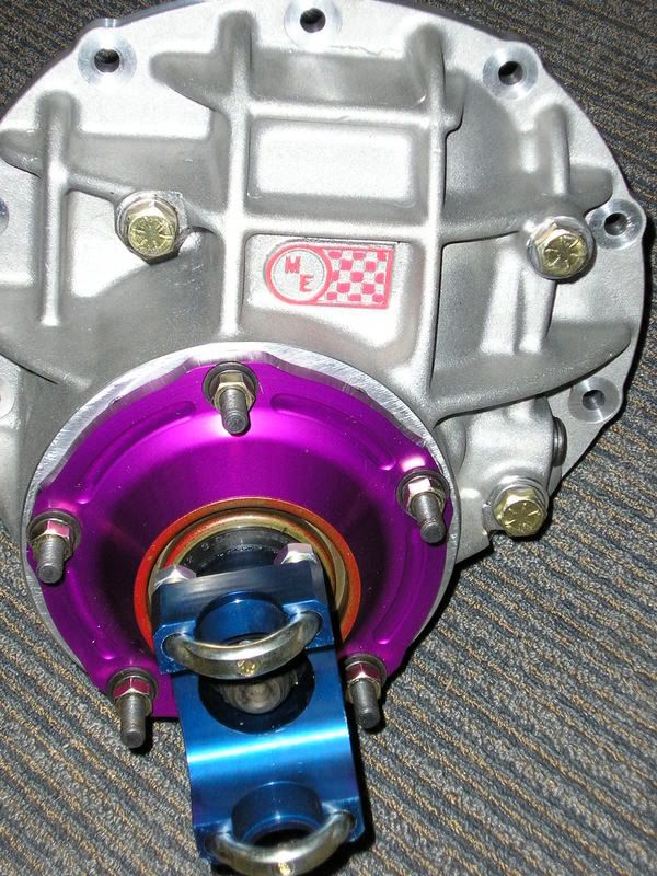

The details are all aluminum 406,Dart pro-1 230 heads(that actually flow 308@.700"),lunati solid roller 260/270@.050-640/669 w/1.6 comp cams pro magnum rockers,super vic,quickfuel 1050,13-1 je's,4340 h-beams,4340 crank,1 3/4 super comps(to be updated to 1 3/4x 1 7/8 step w/1 7/8 merged collectors) 3 1/2 flowmasters,powerglide w/brake,tci ultimate street fighter converter,all moser rear,33 spline,spool,ladder bars,5.13-n/a,4.56 on spray,two stages n2o (150,200-400)
I don't have an et yet it is mostly a street car,but it will get back to the track soon hopefully.All of the work was done by me except the block machine work and the shortening of the rear housing

ok, now i have to wipe all the drool off my keyboard, i have not drooled like that since i was a teenager. sweet motor, good luck with it. \:D/ \:D/ \:D/ \:D/
